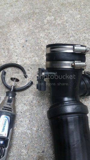

I used a Dremel to trim the narrow end of the outlet off, then the cap fits perfectly and has a lip to seal on.
I might have done that but I didn't want to grind on the stock piece.

Just an update here. Went to full boost yesterday and heard a fluttering sound and power fell way off. Popped the hood and the cap had blown off the inlet tube. Found it laying on the engine belly pan. Noise maker is back on.

Same happened to me, so it cut the narrow end of the pipe off and scuffed up the wide opening with a Dremel sander and now it bites real nice!!!

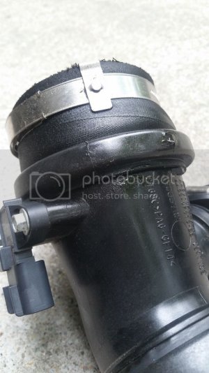

Was checking mine this morning. The cap still tight. No leaks there but found a boost leak on the underside at OEM rubber to hard plastic connection. These two peices rotate freely when I twist them in opposite directions. There is no way to tightened the plastic clamp that holds them together.
20160704 090057 zpsaejtlzpd
OEM failure. Looks like I will be shopping for a new part. Without the noise maker opening of course.

Good find. Let us know if you find something

Did a quick fix for now. Replaced plastic clamp with hose clamp. I may still shop for something else but for now I'm running like this.

That is a hose clamp with a clip on it to hold it in place. Wish they used that on all areas. No failure with that. I left it alone. The vulcanized plastic clamp was the failure. Split it in half and peeled it off.

It's ovious to me this entire part is prone to failure. The other plastic clamp down lower I will keep an eye on. I can fix that leak if it happens. Eventually with high heat and prolonged exposure to CAC sludge the rubber parts will swell and degrade. I won't replace it with OEM. Needs to be all metal or similar plastic to OEM. Couplings of silicone. Aftermarket charge pipe is the only replacement I will consider other than building my own.
