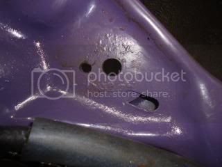

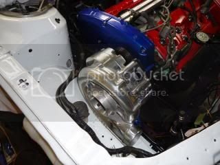

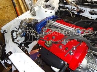

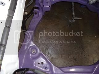

yes its heated and hammered down! i bolted a tranny on and tested it , the only thing i am unlcear about is the front motor mount! i was told with a slo frame all you need to do is space it up! i looks like its not in the same spot as my gen one frame! on the gen 3 it looks at the same position as the rear but on the gen one it looks like the front is slightly more toward the drivers side! maybe half inch to an inch! can someone confirm this? i have saw a ton of frames moded and welded and they all seem to have a piece of metal welded higher and over! my question is what happens on the bottom? if i drill over a bit it looks like the hole will come out where the under side starts to go bigger... do i have to notch it under neath too? if i dont then the nut wont be sitting flat when i go to tighten the front motor mount... i wish people took some pics showing close ups for the front mount on the top side as well as underneath where the nut goes too so that i can see the work done!

lol! i wouldnt leave anyone responsible... i was under the impression that front mount just needs to be spaced! fml...... wish i knew this info was manditory on a slow frame! i used a 1999 frame . but thought the sho one needed to be moded and the slo one was just spaced up slightly! dam!!! gonna post some pics! nobody ever shows the underside!

DSC01286 zpsb7a5453d
DSC01285 zpsb0102c0b
DSC01284 zps86a2c374
DSC01283 zps3d1eb4f5
here are a few pics! damn damn damn!
looks like i needed to weld the plate then drill with a hole saw after on the underside so that i can get my nut on!
7,521
somehow, when Javve put this thread together with all the info on the Gen3 subframe swap, somehow we all glossed over the fact that the front motor mount hole needs to be moved approx 2" to the left of where it appears on the Gen3 subframe from the factory.
That is easy on the 96-97 frames, as you can just drill a hole. On the later ones, you need to drill a larger hole and put a piece of pipe or tubing there so you can get to the location where the nut needs to go on the bottom side of the subframe.

Yes, it's the same idea for the MTX. For the later subframes, take a hole saw through it where the motor mount needs to be (2-2 1/2"), and then weld a 1/4" plate on top that fits in that odd shaped recess. Should take care of it.

ok if you didnt weld a piece on top and just spaced it with washers... i drilled the hole and the motor sits in there mint! i had to use a unibit on the botom to allow the stud to come through , i cant get the nut on yet! need to do the hole saw like stated . is it bad to just space it with washers , cut the underside and say place a over sized washer underneith and just tighten?? wouldnt that be secure or could the metal bend and rip due to there not being as thick as the original .... i will take pics tomorrow and post what i did and plan to do... or do you want that hole motor mount base touching flat steel ??
i spaced up with 5 washer... its basically like 2-3 mm higher then the edge of the frame!
i wish someone had before , during and after pictures!!!! this front mount seems to be as big of a deal as welding the trans mount and adding some material!
