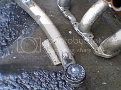

well I give up... here are some pics that I was able to put together... the camera that I have is a wal-mart special and I was not able to get a close up of the ports very well.... so I used my cell phone to get the port shot and its still blurry, best I can do.
First pic is what happens when you pour the acid into the intake (I used the cross-over only for example purposes because it will stand up on its own and easier to shoot (keep in mind I only poured in a little splash to show and as you can see before I could get the shot I already have a mess... USE COMPLETE CAUTION!)
D2872614
And here is the port after clean, Lye and Acid... again sorry for the blurriness had to shoot this one with the cell phone.. sorry you can't make out much
5c74e2f6 1 1
The acid leaves a black film that I found comes out easy with acetone and follow up with a dremel extension and buff pad it looks fairly nice.
Best pics I could get given what I have, good luck hope everything works out for anyone interested..bye.....

as you can see, it boiled over but did not react, I suppose the paint protects it?? I just wiped the spill over off and the exterior is fine...I suppose if you removed the paint? but it would still require hand work, the ports are nicely smooth but far from polished. Kind of neat though, dangerous but neat!
