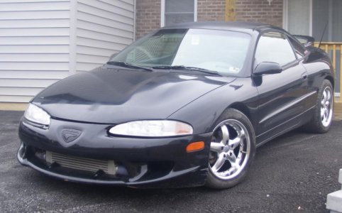

I had a nice black 97 Talon TSi AWD until early July when a drunk SUV driver plowed my passenger side and sent my 3 year old son and I straight into a utility pole. We walked away unscathed but the car was a pile of scrap.
Edit: First picture is about a month or two before the wreck.
New wheels
