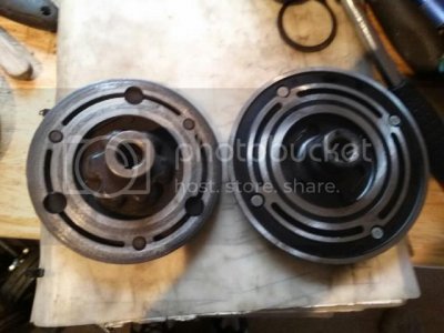

The Motorcraft clutch disc that I received is different from the old one on the compressor even though the part number is the one given. Will this work? I can't seem to find the number for the old disc as it keeps coming up with YB289A.

Looking at this Ebay listing though, this is what the clutch looks like on mine but it list it for the FS6 compressor. You guys think that the old compressor had the wrong clutch assembly on it all along? This is the same compressor that's been on the car since I owned it and it is a 10P15F.

the 'new' one looks correct. the 'old' one does not - I don't know from what it came, but it was not the correct SHO a/c clutch part.
7,521
no, those are for the FS10 (standard slo) compressor, even though it lists them for the SHO. there are two shims in there from the factory, one is only about .050" thick and the other is maybe .100" thick, iirc. it doesn't really matter how you get to the right air gap, so you can find any shims that fit on that shaft size and give you the right gap.

Well this explains why my crappy reman compressor died within a year. It had one like his old one as Jim has shown (the one stamped 3345). The NEW one he has is the one I have on the NOS compressor. That's the correct kind original from the factory, as stated. I had issues with my clutch not engaging when I had one that looked like his old beat up looking one. I guarantee you that the material on that other one is not strong enough to make a good contact, caused slippage, overheated the clutch and the shaft seal, and caused it to leak.

Actually the compressor has lasted as long as I've owned the car. But looking at the size of the old pulley with the new, I can see why the bigger one is used to keep the compressor from spinning itself into burnout. And it shouldn't feel like it's sapping so much power when engaged.
