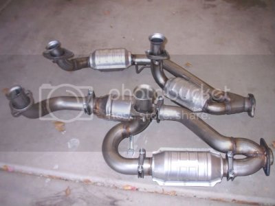

As for equal V. unequal... I ended up selling my equal length y-pipe b/c I did not like the 2 to 1 "collector" where the pipes face eachother see pic. Also did not want to have to go through the process of installing, fitting, removing, welding, reinstalling the equal length; the magnaflow fit fine. Although the equal length is supposed to be worth a few extra hp and sound better, I would recommend the magnaflow http://shosource.com/catalog/product_info.php?cPath=43_54&products_id=52 SHO 1032 1

I would buy the current SHO Source unequal y pipe again above any others
price, size, and fitment quality are what seals the deal for me....
if you look inside the exhaust at the merge it looks a lot better then it does just from looking at a picture of the outside... if u want to complain about that and count horsepower like your pennies, then really none of the aftermarket y's that are intended to go onto the stock y pipe are the best design possible....

yea the restriction from the cats isnt very noticeable. the real problem with the stock y pipe is it has the pipes coming off the exhaust manifold go STRAIGHT down and the collector is not well made and its crush bent instead of mandrel

Very good points! From my experiences though, the equal length tends to have alot less rasp, esspecailly when coupled with a good resonator!;)
As far as HP difference goes between equal & unequal, you're only talking about 1-2 HP, so i wouldn't be worried al all about that. Anything is better than a stock y-pipe!
