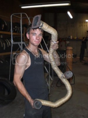

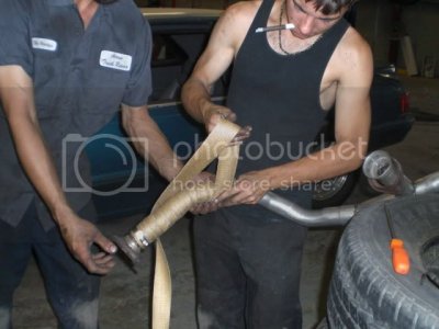

Turbo up pipe, which is about as long as a stock downpiipe, I used about 50 feet if I recal correctly.
CIMG0565
CIMG0566
Thats how it turned out...
