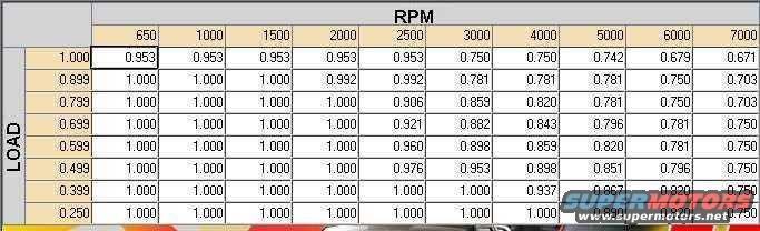

Here is the stock AF settings for the D4U1 PCM. Multiply the number in the table times 14.6396484375 to get the actual targeted ratio. There may be other parameters that will be applied to this number to get the actual commanded AF ratio.
EDIT: Fixed the XY labels.
D4u1 stock fuel tables

looks like the Load and RPM labels are backwards... at least I hope they are because it makes no sense otherwise! lol... so at 100% load and 7K rpm the ECU is commanding a 9.82 AFR? That's more than pig rich... that's like Bernie Madoff six months ago rich.

The labels are backwards. More than likely on a stock motor you will never be in the top row either.
Its also "wash the oil off the cylinder walls" rich, imho.

so would the engine benefit from running something closer to 12-13s, vice 10-11s? And would it really be just as simple as changing the upper numbers to .800 or .850 instead of .68 and .7?
EDIT: Obviously, that table isn't from the tweecer, as the tweecer doesn't contain that table for the D4U1. The only closely related fuel tables are fuel-base and fuel-stabilized. Which one would I dick with to change the OL behaviour?
