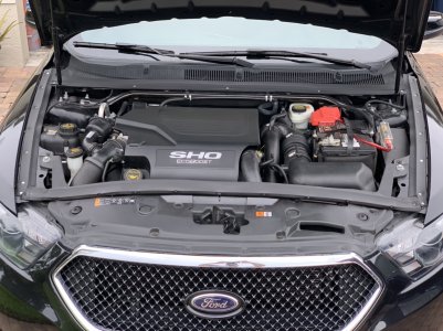

Hey Everyone,
Trying to figure out the best course of action here, at "high speeds" my hood shakes and wobbles so violently I think it is going to fly off. Obviously wind is getting under the front lip and lifting the hood. My car is missing the hood insulation piece on the bottom side of the panel, however I cannot imagine this would completely remedy the symptom. I have also installed a thick rubber seal on the front edge and sides of the hood which only helped slightly.

David Owen
Feb 14, 2019
31
7
Fort Lauderdale, FL
Above and beyond guys! Thank you for the help. I actually went so far as to build a sealing structure under the hood, not knowing what else to do... kinda looks cool in my opinion...3a18c51c0a1fa07f85f91b313117d7d2
