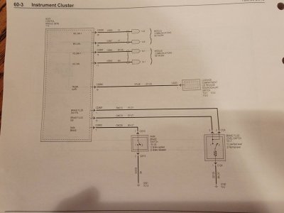

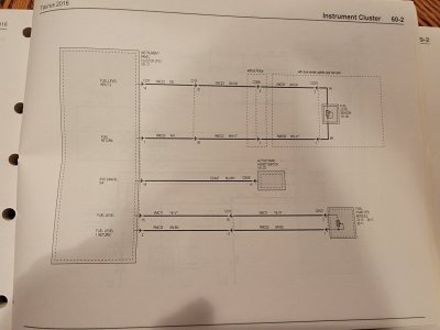

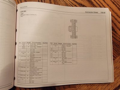

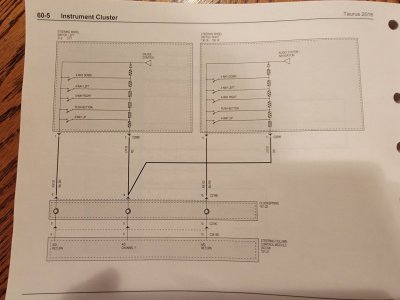

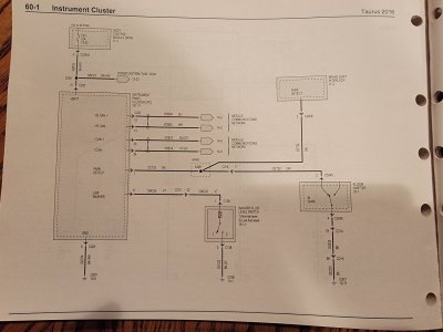

Specifically, the wire colors and that they go to for the instrument cluster/gauges.
The wiring diagram for this car is like 400 pages. I'll see if there's a page or two I can send pics of that will help, but it may be more useful if you just say exactly what signals you're looking for. Also I'm heading out of town right after work today so I might not get to it until sunday

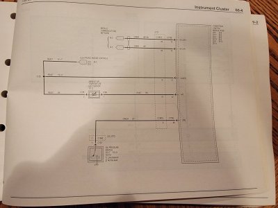

Well, If you can just list which color wires are which on the instrument cluster, that would be adequate. I am looking for the ground, positive, CAN H, CAN L, at minimum, but it would be ideal to know them all.

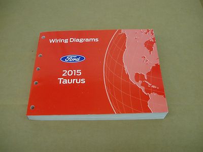

I own the red wiring book also. Got it from ebay, they pop up every now and then for cheap. Workshop manual i have is a cd, i "borrowed" it from a ford tech in 2018 and still have it.

Here you go sir. Looks like that should hopefully be everything. But sometimes you have to look in odd places to find some things, so if there's anything else needed just let me know!
