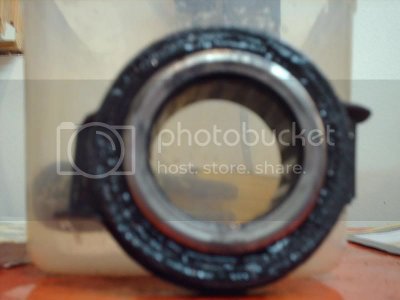

The TOB is covered in what looks to be oil. Wered that come from? Other then that it looks to be in PERFECT shape. It spins like it should and has no play.

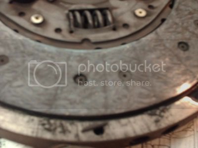

Blurry pic but the clutch disc itself doesnt have much life left in it. I think someone road the clutch a bit. I dont know how much the GF will be driving it once te stage 3 clutch is in. :p

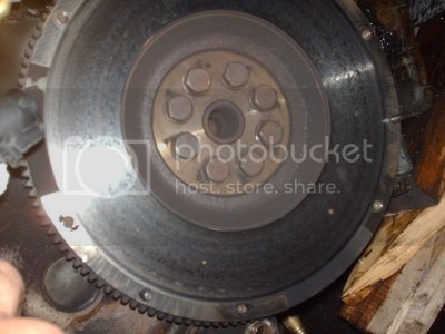

Flywheel shot for ***** and giggles.

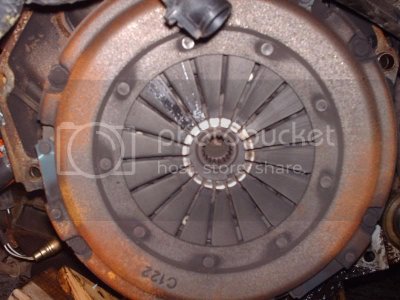

I havent found anything that looks like it would cause the symptons ive had except the oily TOB. Any ideas? I cant figure out what the exact cause was.

What the upper clutch strap looks like? I looks like a snapped strap with the symptoms you just posted.
Other then that , maybe the cable or the adjustment on the pedal , because everything else looks normal to me.
EDIT: What about the 4 springs in the disc , are they all there and intact?

Get the flywheel ground while you're at it.
If the rear main oil seal isn't leaking (behind the flywheel), then I'd guess somebody thought it was a good idea to grease the TOB during the last clutch install. The "black oil" may just be grease with clutch dust mixed in.
I wouldn't re-use the TOB regardless of how good it looks.
