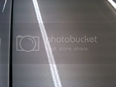

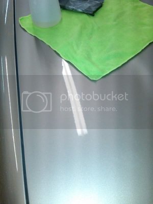

Before wetsanding:
IMG00018 20110714 2127
After 600 grit then 1000 then 1500, then polish. (about an hour and plenty good for me)
