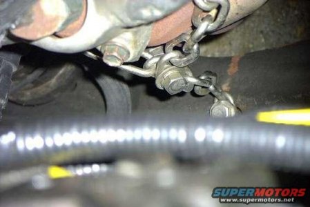

I use 18" of chain to limit the backward movement of my engine. Works great.

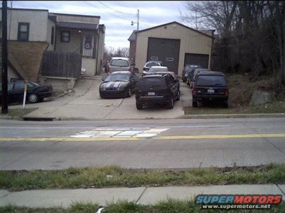

yellowSHO:
Carter, is that your car with the striping? It looks great!
No, that would be Mike.... MIKEBSEXY from SHOcago. Eric Lehman prototyped the Supercharger on his. Any stripes on mine would be yellow naughty
