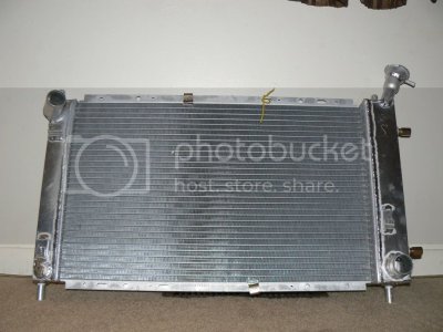

...I have an ATX, and have been waiting for the same answer. I'd like to know if the MTX rad's are plug and play, or not.

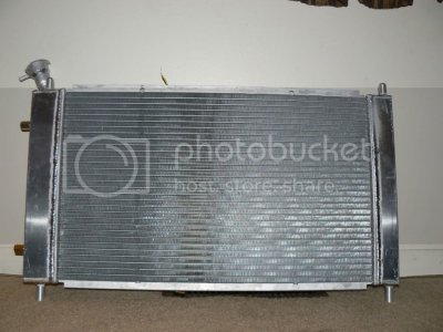

If it works on any ATX Taurus from those years, it will work on any other ATX Taurus. Same rads as the 3.8 and the Vulcan too, as well as the ATX SHO.
Plus, looks like they just send the ATX one to the MTX guys too, with the tranny cooler plugged. You should be fine.

So that is a dual core, with the holes not plugged on some for the atx, which means I would have to plug them for my MTX?
Thinking of getting this soon. My plastic is getting aged, had a crack to repair and a pinhole to fix.
