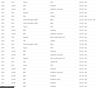

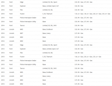

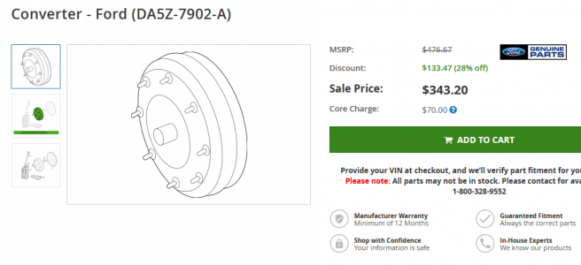

This should be available from Ford. Application shows 2010 MKS only however, it fits all SHO from 2013 forward. It probably requires a new flexplate, 4 bolt to 3 bolt or vice versa.
1719091312000
1719091462109
1719091809018
Fits these and many more.
