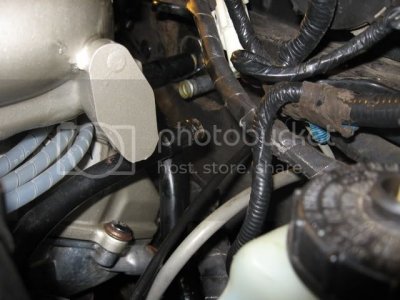

The black hard pipe with crimp and factory rubber hose removed is shown in the center of the photo. The bead is visible. The gold colored ****** in the background is the heater core .
Pipetofirewall2 1
