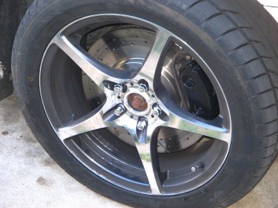

MSR 190s
$450 shipped from James (SC and SHO Blazer)
519290745 8c51b18ee2 b
535191052 45a2460ce1 b
Weigh the same as the Enkei's Sam posted and have the same dimensions, clear Cobra brakes, look hot.

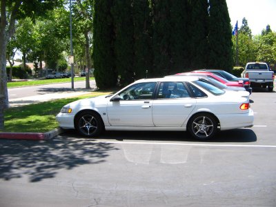

A 17x7 is really too narrow for a 235/45-17, most OE 235/45-17 installations are 17x8 and I think 7.5in is the narrowest tire-mfr recommended rim width.
I'm running a one-of-a-kind, third-hand, welded-a-couple-of-times, straightened-and-refinished set of 17x7.5 ROH ZR6s - they're straight, not too heavy, not too light. Right now they've got a set of 235/45-17 Bridgestone S-03PPs on them and they are, as I noted, about the narrowest wheels I'd put those tires on.
Got a set of 17x8 Ronal R41s on the shelf, a little lighter, haven't had them mounted yet.
