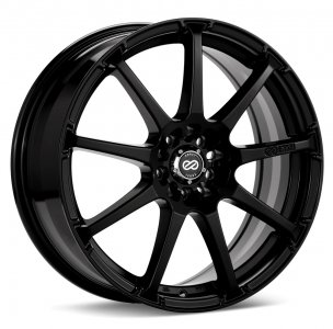

and also have you considered enkie edr9's in gloss black? I can't post the ebay link here but this is what they look like.
btw I have a 92 black/black as well, and this is the Rim I going to go with after the winter
This listing on ebay is the only listing I have found anywhere for edr9's for the 5x108 pattern. By any chance, did you contact the seller and confirm that one of the bolt patterns is really ours?
Even the Enkei site doesn't list 5x108 for the rim, but they also only list one pattern and it's clearly a dual pattern wheel. Very weird.
It's a nice looking wheel, just wondering if anyone had already confirmed it really exists.
Jh8990
Jan 22, 2009
419
109
New Jersey
I will be ordering these rims when it gets closer to christmas time so I could confirm then. however all these rims are, are gloss painted black versions of the enkei cdr9's which Ive seen and know personally a few SHO's running them. so I know they do make them in our bolt pattern.
and you can't say that it is not one sexy looking wheel. :)
