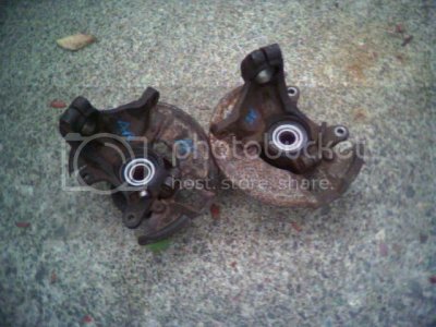

I recently picked up a set of 94 Knuckles with "new" wheel bearings in them. I put them on my SHO with the 96 Brake Upgrade but now I can tell that the passenger side wheel bearing is bad. How much am I looking at to get some new wheel bearings pressed in?

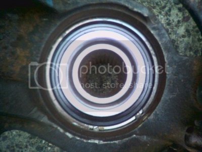

I recently pressed in a set of bearings on my own 94 knuckles. Upon removing the hub on one, the hub shaft de-laminated and I needed a new hub. Hub was around $70 at Autozone (Armistice Blvd), including a new bearing.
PROBLEM:
The bearing they include in the cheapo kits is just that - cheapo. I use Timken bearings, which are around $40-$50 each from memory.
Actually pressing out the bearing will depend on where you take it. Now that I'm set up to do them, I can replace the bearing for $50 each with the knuckle already removed. Turnaround can be a couple of days as I have to wait for press time to open up at the shop, or stay after hours.

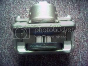

Here are my new loaded calipers I bought. I just got the caliper mount bracket to knuckle bolts today, so the SHO will be running again soon.
Caliper1
LoadedCaliper
