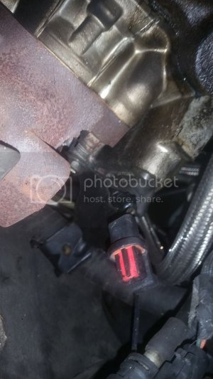

It's a 2 wire plug coming down behind the rear most head and is hanging maybe 2 inches above I believe the oil pressure sensor
Jesse Menck
Mar 19, 2015
163
23
20150429 164214
Hopefully that helps small black thing dead center of picture my battery died tried to get a shot from below

So it is below the right hand head (even though it's transverse, the trailing head is still on the right), and near the front or the rear of the engine, from its perspective?

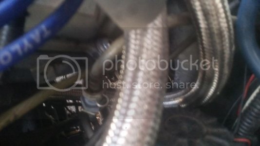

Sorry if you look where the 2 braided tubes cross it's the little black thing above the lower one and to the left of the upper one it's currently hanging basically straight above the oil pressure sensor and is probably 2 inches up the block from there because the harness length it's not behind the motor toward the drivers fender but between the firewall and engine

I don't think it's the hood light. The hood light is a bigger male connector that is grey. That one you have there is for a sensor in the heater hose. On my 91 there is a metal coolant line that goes right through there with a bung welded into it for a sensor that that connector goes to. The pipe may have been eliminated over the years if it rusted out causing a leak and they couldn't find a replacement pipe and I would guess that's what happened to yours because those braided lines are your heater hoses correct? I believe that the sensor is probably the coolant temp for the climate control but I'm not 100% on that. I can post a picture later if you need it.

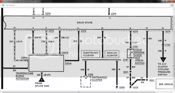

I'm curious what that sensor is actually for if you have that information. On mine the wire colors are yellow with a white tracer and the other wire is black.

Lol hopefully you can find that manual one day Tom sounds like it has infinite SHO knowledge in it! Would be a shame for it to be gone.:mecry: However this has kind of been driving me crazy what the sensor is for so I found this diagram for the HVAC online. I found the climate control does utilize what they call a CELO sensor to monitor coolant temperature to keep the heater from turning on until the engine is warm enough to provide heat on automatic climate control cars. It also happens to be a yellow/white wire and a black wire.
Wiring20diagram
So anyways, long story short Jesse if your car doesn't have the sensor or doesn't have automatic climate control in the first place then I would recommend to just tie the connector somewhere out of the way and forget about it. Or if you are trying to restore the car or the climate control operation is very important to you then you can try to find the original metal heater pipe somewhere but I would imagine they are hard to come by, heck I didn't even know that it existed until you posted this. The only thing the sensor controls is the delay for when the climate control will turn the heater on if the heat setting is selected on a cold start. It will not affect the engine or anything with how the car runs or drives.
