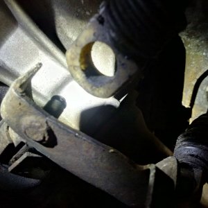

What fell off my shifter linkage?

1. You can wire it back together with mechanic's wire.
2. You can use one of the clips from the bottom of the hood strut to keep it on.
3. You can find new cables.
4. You can convert to a rod shifter.
I've done all 4 :)
Devin
3.Slow
Jan 15, 2003
3,542
932
Pacific Northwest
I ordered a bushing from SHOSource that should help. I can't do a temp job as I am looking to sell it.
