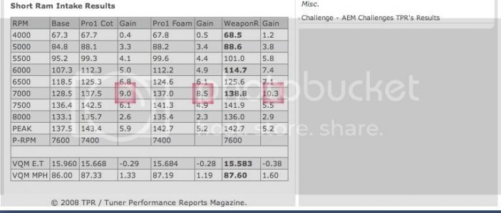

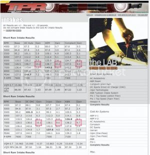

All that shows is that the WR intake is within the margin of error for all but 3 of the intakes tested.

EXACTLY !!! it shows that their patented system that rams 3 times the air down your engines throat is BUUUULLLLSHIIIIIT
edit: hence the snake oil comment
