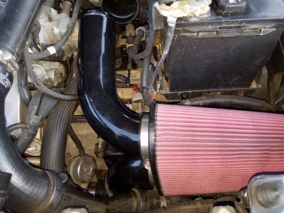

I'm going to make a cheaper knock-off of Hennessy's and bpd1151's intake. i will make a write-up as i go. I just need to wait for the air filter to come in to measure the inlets and i also need to measure the turbo inlet as well. i will be using am inter-cooler kit off of ebay and use couplers to join the pipes. (i haven't decided whether to expand the pipes and put one inside the other then couple it together and weld it down the line. Also black inter-cooler pipes or normal polished aluminum pipes)
I will be posting future updates here so if you guys have any comments or suggestions post them here.
Also if you guys know the measurement of the stock turbo inlet that would be great.

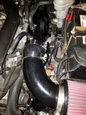

It looks like I need a 15mm drill bit to install the grommet. I bought 3 for $22
Done! C18c0969f15fdd35658ee34ed7f8bf50
D3422d354399f9f9e996acd24da03131
2149530b77acfe254571aefc8663419c
0a60b4571b7d206dc666f5e3bd4dd9f1
70a745c7cc5feaf86f563fda06602aaa

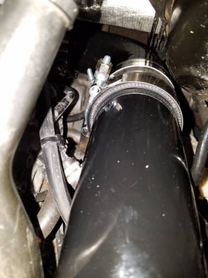

i used a hacksaw to cut the piping.
and a deburring tool
How to make it (all you need to do is cut and drill 3 holses)
Rear turbo < Piping Reducer 2" OD to 3" OD <3" coupler < 3" 90 degree intercooler pipe<3" coupler < 3" 45 degree intercooler pipe < 3" coupler < 3" 90 degree intercooler pipe <filter
Front turbo < 2" to 3" 90 Degree Silicone Reducer Elbow Black < 3" 90 degree intercooler pipe <filter

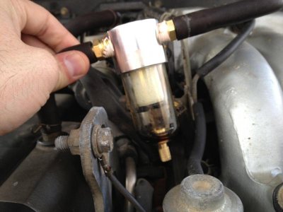

http://www.ebay.com/itm/Clear-Air-O...ash=item1c78f21595:g:p4gAAOSwZQRYXcbL&vxp=mtr
Thoughts for this PCV system for the front? it has 3/8" barbed fitting with 1/4" NPT threads
It can withstand 150PSI
i might as well be the first one to test it out and if it works ill use it on both sides
Edit: i just realized its a ******* overpriced compressed air filter with the inlet and outlet switched
I'm going to try it though

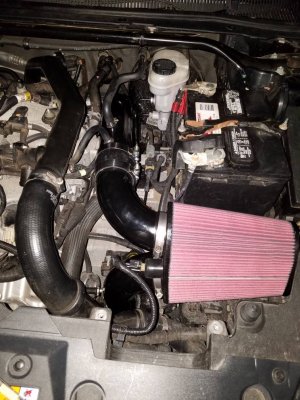

Little update
124463e55e5585711a0eba81edd541e5
Unfortunately I do need a 2" to 3" metal pipe for the rear Turbo or a 2" aluminum "joiner" pipe

Yeah, unfortunately these are hand made and not perfect. I'm using a hacksaw, maybe I can use a band saw or something. I just need to dial down the measurements and stuff. When I'm finished I should have a revised items needed.
If I were to sell them I would use 6061 aluminum with fitting you can screw in and have them powder coated and shipped. If I has access to my dad's tools it would be no problem but unfortunately I'm very far away and living in an apartment.
