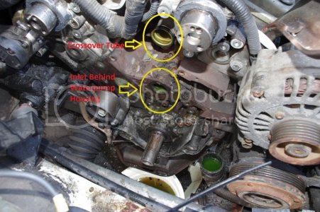

This^^, I think the seal at the water inlet behind the water pump housing is the first thing to start leaking. If you mess with the water pump the housing will come loose in the process and if you don't replace all the seals you will regret it down the road.
WPdiagram zps91dd478e
