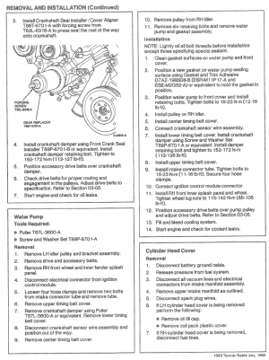

My '91 SHO decided that today was a great day for the water pump to give out. I was wondering if anyone on here had a PDF file of the repair manual so I can see what exactly I am dealing with? I am looking all over the internet and can't find one anywhere. Any help would be greatly appreciated. Thank you!

I can take a picture of everypage in the book unless someone has a pdf

Id rather get you more info then you need then less so heres some pages from my 89 book. Let me know or pm me if you (or anyone) needs any other info i can take pics in the ford book. I have every gen sho books and cds, i love helping people and will go out of my way to.
View attachment 16615 View attachment 16616 View attachment 16617 View attachment 16618 View attachment 16619 View attachment 16620 View attachment 16621
You are the GOAT! I really appreciate that. I still will go ahead and buy the manuals as suggested just in case. Thank you!
