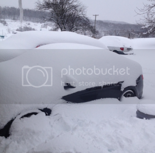

Opened the left side passenger door today and water poured out from the door seal, probably from all the snow we had last week melting off the roof but it shouldn't have made it inside the door.
