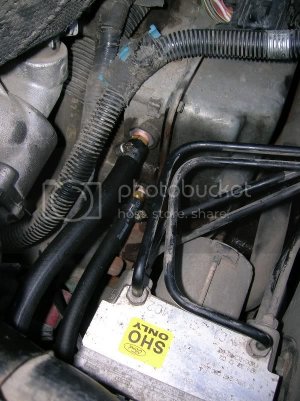

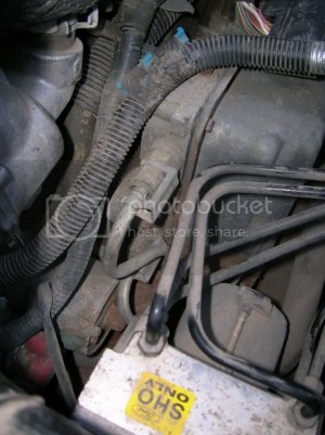

Tranny goin south?
Mine does the same thing and it's got twice as many miles...
Don't be like me and wait to put on an extra tranny cooler.
Factory lines:
NikonPhotos093
New barbs and tranny hose:
Mytrannylines

The cooler is from a Gen II ATX SHO, I got it for 20 bucks from a JY.
I could do it again once it warms up, it was pretty easy, as long as you don't need to go to the parts store three times like I did. Barbs, Hose, screws to hold cooler, aux cooler, hose clamps, and more fluid.
