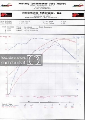

Torque curve charts are disappearing off the web; here's a nearly-stock tune, and if you use your imagination, you can see there might be room for gains between 3600 and 4200 in the top blue torque pull by slowly opening them early.
