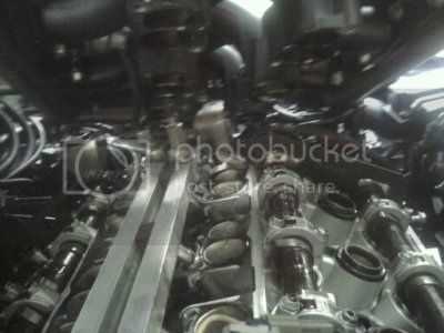

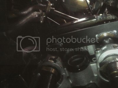

Got the valve covers off and set it to TDC. Cam holder tool slips right on both pairs of cams. It's in time.
Intakes check out at 0.008.
Exhaust is 0.012.

These are the cams at TDC:

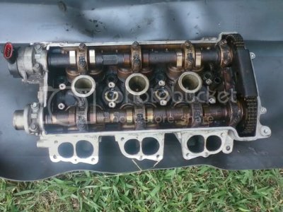

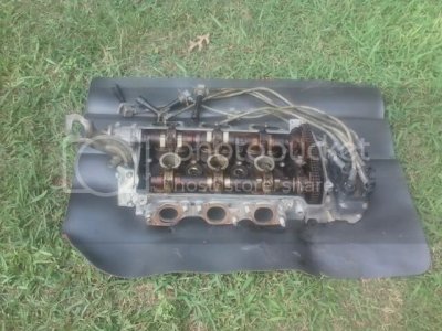

nice clean engine

Thanks for the complement. The heads used to look like this:
