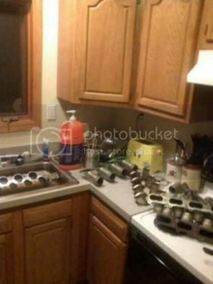

So I got overly ambitious yesterday and ripped the upper and lower intake off my 98 to clean it...
98intakeinthesink
yeah...my new wife found out the sink can double as a parts washer. Just wait till I show her how well the dishwasher works. :woo-hoo:

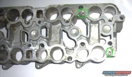

"There are two spots on the bottom of the LIM that need filled too."
Paul, what are these holes? Air bleed or set screw lock points?
I missed THIS in my pull down....
It might be a source of vac leak for me...
THANKS
