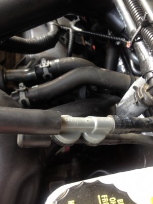

I've noticed just a hint of a noise or whistle associated with decell that I wasn't aware of during the recent past. Kind of a hard to quantify or pinpoint high pitched moan. I can hear a hiss around the windshield/cowling on the driver side (pic). The car is unmodified and there are no lights or codes. This isn't a normal sound as far as anyone knows is it?1d1dc4555f593b5c8b215c2a8833984b. Thanks for any info.

Pretty hard to tell, can't even say 4 sure the hiss I hear is related. Lacking a stethoscope I feel like the hiss originates from the lines secured with a tie wrap in my photo.. I would assume that with the level of electronic sensors and monitors in these cars, if there was an issue it will eventually throw a code. I'll just wait and see I guess. Thanks for your reply and any further knowledge u share.

The "lines" secured by the tie wrap in your photo appear to be a wire harness in wiring loom (upper) and what appears to be a coolant line (lower), so neither of those would cause a vacuum sound.
Is there a chance the noise you are hearing is the blow off valve (BOV) for the turbos? On rapid decel the BOV may vent to relieve excess pressure in the intake. It would be very short in duration, and usually in stock trim (un-tuned) the BOV isn't noticeable, but still something to consider.
