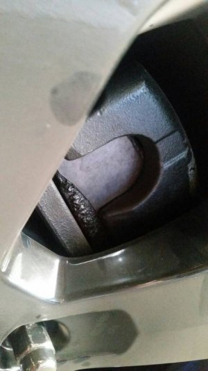

Here's what EBC red stuff pads on slotted rotors look like after amateur hour on the track.

SHOnUup4
Jun 17, 2014
927
777
SE MI
And, all the guys that track their cars...were preaching exactly what Ron said above.
78cba965abdaf6b1f4221e2376271bf8
Melted???? Seriously? Is that a "how you drive" or just characteristic of the Red Stuff... or a characteristic of the slotted rotors?? I thought the EBC Red Stuff were supposed to be good? To melt like that?? What about having separate "track day pads" and "DD pads"? I was already thinking of maybe getting Yellow Stuff for track days - reviewers say they work better at temps than reds - lots of dust but work well... so they've said. Honestly, I find the picture above to be a bit concerning. :eek:
SHOnUup4
Jun 17, 2014
927
777
SE MI
My pic posted above was after a day at a road course...my first time ever.
The slotted rotors and red stuff pads do a great job at the dragway and for DD use.
EBC sells better pads than th red red stuff for track purposes, and I found out why. My inexperience combined with slow traffic on the track resulted in extended braking periods for 3 laps, rookie me should have pitted and found an open section to join back in...live and learn.
Blank rotors and high quality pads are in my future as a 2nd set, will keep the looks of slotted and red stuff pads for DD & shows.
