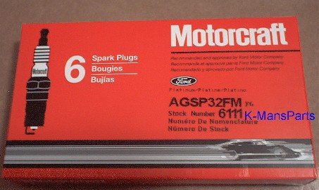

For plugs, I would use the Motorcraft ones, e.g.
http://k-mansparts.com/items/taurus-sho/ford-taurus-sho-motorcraft-spark-plugs-mcshoplugs1-detail.htm
SHO20plugs20AGSP32FM
