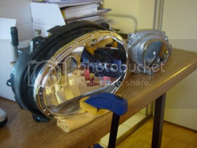

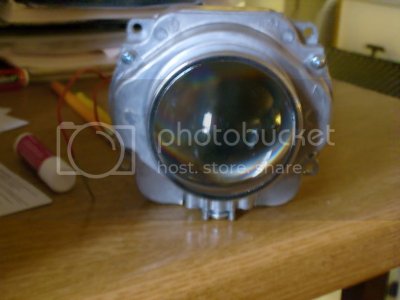

Okay well I am now working on the Gen III Projectors, The first set I am putting together is with a set of FX-R projectors. I will be trying them in both the 35W and 50W configurations with bulbs between 4300K and 6000K to try and find the optimum setup for the Gen III. I have already tried the Morimoto Mini in the D2S configuration with 35W ballast and 4300K bulb and am happy with its performance. I may try the Mini in the H1 configuration or even the Acura TL projector next to test them Any input would be great. S6301336 S6301337

Fortunatly the Gen 3 lamps come apart pretty easily and come with the clear lens. I will be playing with mounting this during the week and hopefully have it ready to put in the car by the weekend. Hopefully everything goes smoothly. I have to pick up a new hole saw to use on this one as it needs a bigger hole on the backside compared to doing the
D2S projector I used on my current build. I also need to fabricate the mounts for this one also because of it not being flat on the bottom of the lamp housing, otherwise I could just use a L shaped bracket to mount the bottom of the projector with.

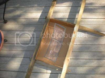

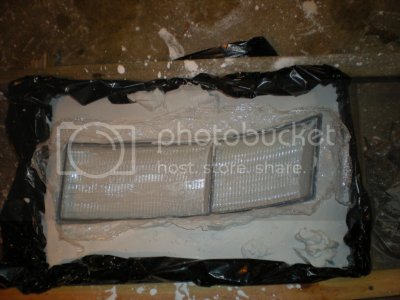

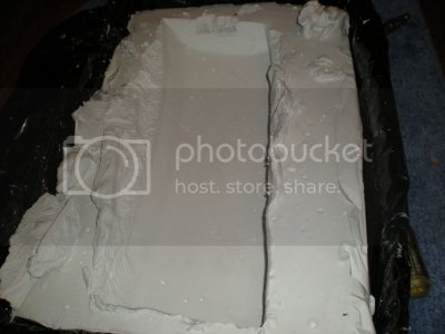

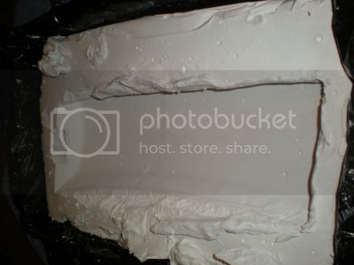

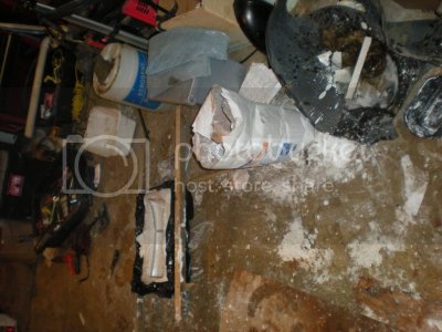

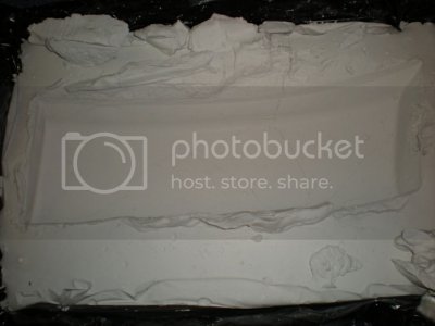

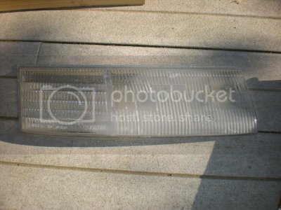

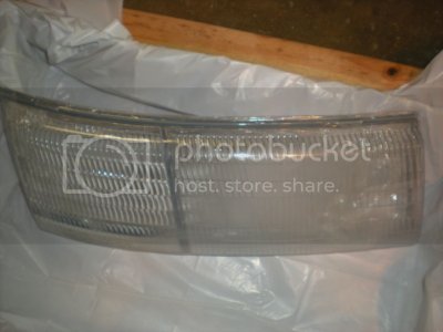

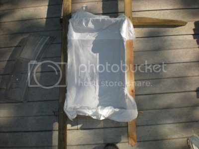

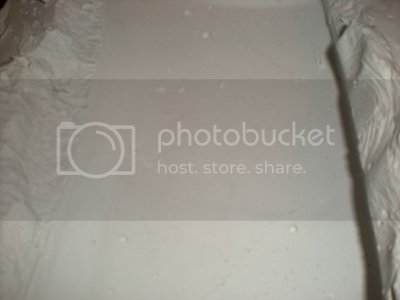

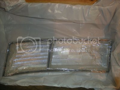

Well started to make my negative. It was a royal pain in the **** to get it.
Took my new Headlights and split them up to get them use able.
DSCN3679
DSCN3680
DSCN3681
DSCN3682
DSCN3683
DSCN3684
DSCN3685
DSCN3686
DSCN3687
Made a bit of a mess. :nut:
DSCN3688
DSCN3689
DSCN3690
DSCN3691
DSCN3693
The mold cracked in a few places when i was removing the Lens but i think i can work around it when i fill the air bulbs and start to make my positive to use in vacuum forming the new clear lenses. Should get the other side down tomorrow and then start looking to a friend to help with the Fiberglassing. I Shall keep you'll updated as i move along.

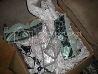

Plaster Negative molds are drying then im going to sand and fill holes. The im going to start fiberglassing out the positives.
My Morimoto Mini H1's should be here today and im going to start fitting them ASAP.
