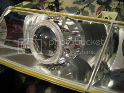

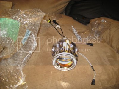

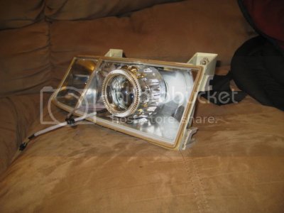

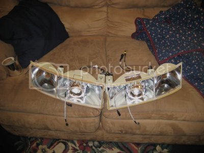

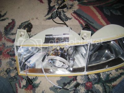

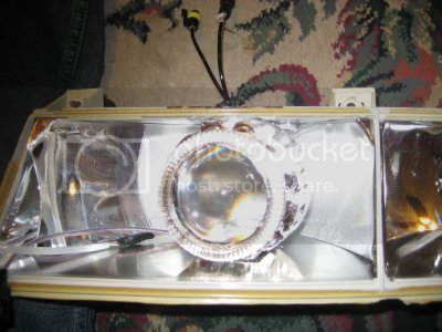

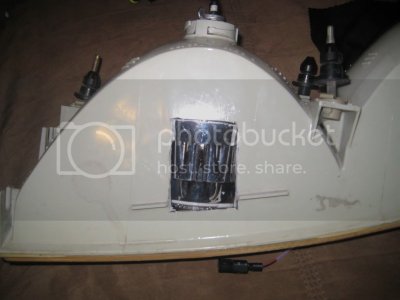

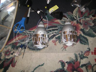

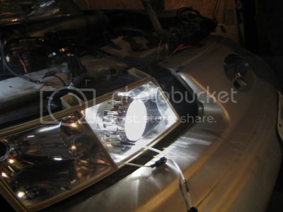

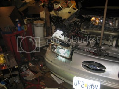

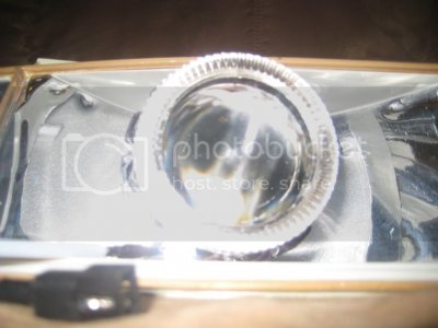

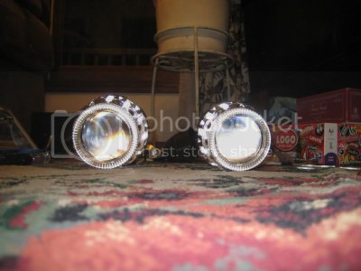

Well as we all know the headlights in the SHO aren't the best. Im pretty big fan being able to see at night when im driving a road at...well above the posted speed limit. The best way i know to do this is with projectors. No way to get around they are amazing pieces of engineering and work amazing! As someone called them, they're the Polite-ist headlights on the road. Lol. But ive notice NOBODY makes any sorta of after-market any thing for SHO/Sable. So ive picked up a set of old head light housing s and went to town thinking about how to do it and ordered a set of projectors to stick in there and bought headlight covers to make clear lenses out of (which are not here yet :frown: ) i got one side installed tonight and drove a bit to get the feel of these things and HOLY COW do they put out light. I have yet to install the harness to run the HI's on it so all pictures you see will be LO's and also the other harness i have for this kit will also run the LED ring around the outside and are running on 55w DDM tuning ballast . But i figured you all would want pictures of what I've got so far. If the response is fair from you all and enough people are willing to buy sets i shall consider making a sets of these for sale.
Oh and the projectors i got are HUGE and needed a little cutting to get them to fit, if i start making larger numbers of these i will try and find a smaller projector to stuff in there and mount.
Let the picture fest begin:

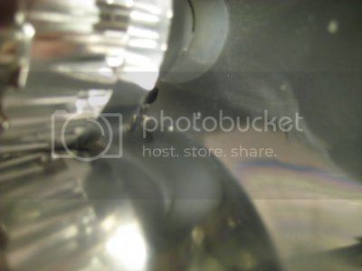

This is hole i had to cut to get it to fit, most likely could be smaller for future production.

So, what do you think? Comments? Who wonts a pair?

Looks good so far....I know when I did my projector install I had to trim the shrouds to fit nicely, any possibility of doing that to avoid cutting the housing? Looks like a H1 buld setup, be careful running the 55W with the small projector as it likes to burn the bowl area of the projector. I have a similar projector in mine but it is D2S bulb and I have stuck with the 35W to keep from burning the bowl area. Next question ...is that a 70 or 69 Cougar....Had a 70 as my first car...lol.

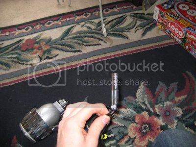

I think im most likely going to find a set of 35w ballast to run. I had thought about cutting the shroud to help it fit inside the housing but on a trial run id rather not mess with my projector till i got a better understanding of how this was gonna work. So i will most likely end up using different projector to run in the housing to make room. Im not for sure on the style of bulb they use, id like to know, I grab a picture and throw it up of the bulb.

As stated, I have been working on getting a nice projector together for the SHO community. I have a set that I have installed in my own SHO that I have gotten to enjoy over the past couple months. I now plan on trying out a couple more projectors to see if I can step it up a notch more from what I am enjoying. The base system will be as stated a 35W system due to the size of the projector (any more and you will burn the bowl area). The 35W system puts down very good light and is easy on the eyes. The other projectors that I am going to be playing with offer even options as they can be ran with more wattage if the buyer wanted to. The buyer will also get to choose the shroud design they want and with or without angel eyes. These will also be bi-xenon, but a set of low-beam only could be done if the customer wanted that. The attached picture is of the baseline projector I plan on using. Anything else will be a step up and I will let you know before I build them what it will cost you. Minih1sentra

I'm actually kinda curious, why cut the headlight housing and not the projector shroud to fit in the headlight housing? I usually see it done the other way.

Was done only as a mock up .....Didn't want to destroy the shrouds. Probably could have just taken them off instead I guess.

The style i got has the shroud and lens all in one... terrible terrible terrible design.

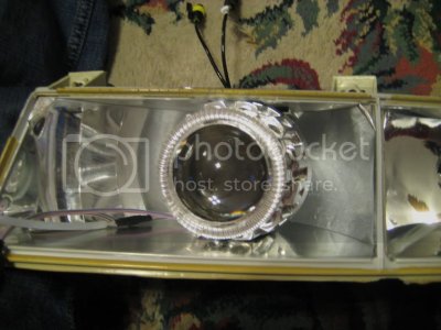

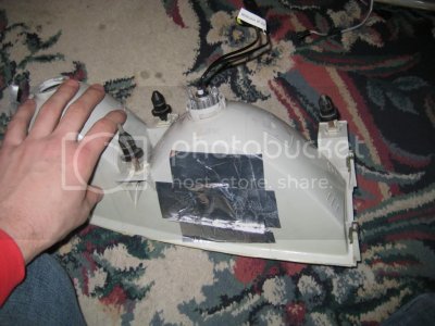

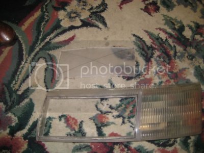

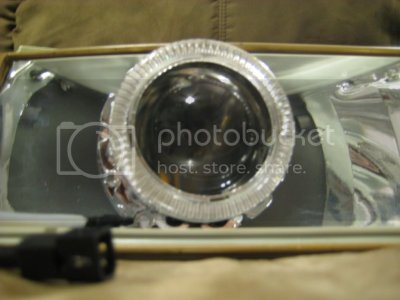

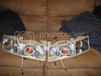

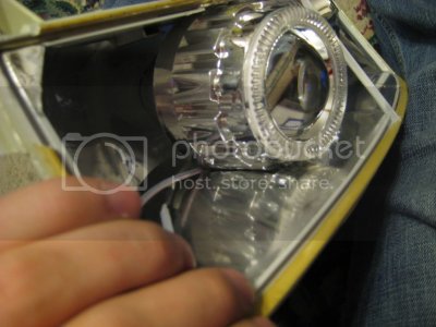

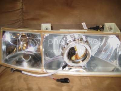

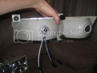

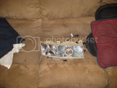

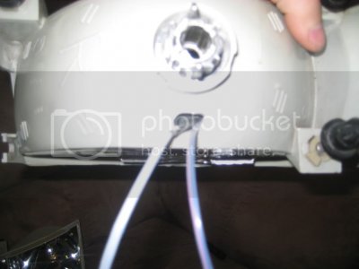

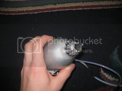

Update on the other side. I found that the way the projector was being pushed a bit down so i had to remove a bit on the top and now the projector slides in and out easy. Also it insures the it seated on the back of housing making them aiming a lot easier. I used very high quality tape to seal it all up. Overall it looks very good on the inside. cant even that its been cut to fit.
Pics:
IMG 2204
IMG 2202
IMG 2206
IMG 2207
IMG 2209
IMG 2210
I plan to copy the the removing of the top bit of plastic seams that the projector isn't being pushed down and made the aiming better.
IMG 2200
IMG 2201
Heres a picture of the bulb:
IMG 2196
And the back of the bowl:
IMG 2198

I plan to take a drill bit and drill out a small hole for the LED ring and for the Hi/Lo power in the back out of sight and seal it up with some form of caulk.

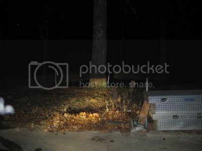

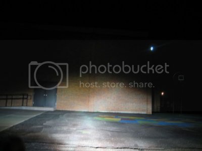

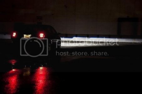

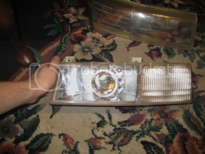

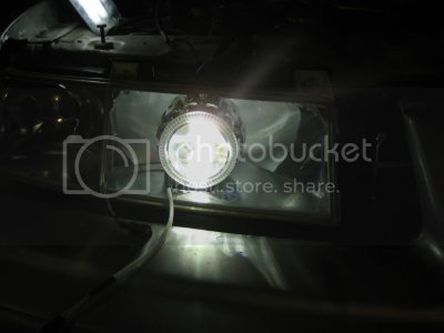

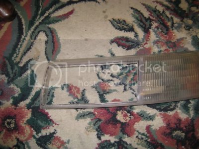

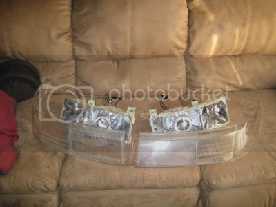

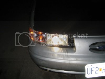

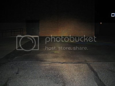

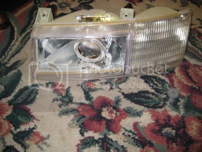

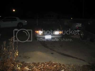

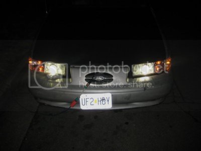

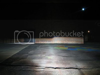

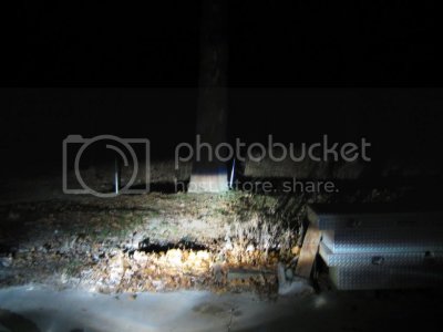

Well the Covers came in today and i started to think on how im going to do it but once it got dark i gave up on it and went out to play with them in the car. Man oh man are these things awesome. The light out put is unbelievable, and they look mean as **** on the car. Hopefully sometime this week i'll get LED's wired up and get pics of them running. But im gonna be working on the lenses almost full time now. So expect them to be done before the weeks over.
Now on the the good stuff, Pictures:
IMG 2213
IMG 2214
IMG 2215
heres the hole. hidden behind it. you cant see it all from the front.
IMG 2217
I cut the lens out on one and decided to wait before i did the headlight cover. but heres how far i got.
IMG 2219
IMG 2220
To show what the final product is going to basically look like.
IMG 2221
IMG 2223
Low Beams
IMG 2226
IMG 2227
High Beams
IMG 2230
IMG 2231
And heres a shot of them running in the car. Ignore the beat to **** car.
IMG 2234
