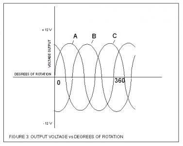

When figuring out the watts-hp computations you also need to figure in the efficiency of the alternator. I really don't know what it is but when the AC is converted to DC a good 4/5s of the AC current is wasted. Can't use any of the negative side of the sine wave and you need to chop the bottom of the positive wave off to.
Here is the three full AC sine waves produced by the alternator.
Altfig3

<small>[ January 10, 2003, 11:16 PM: Message edited by: SHOZ123 ]</small>
