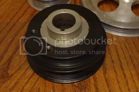

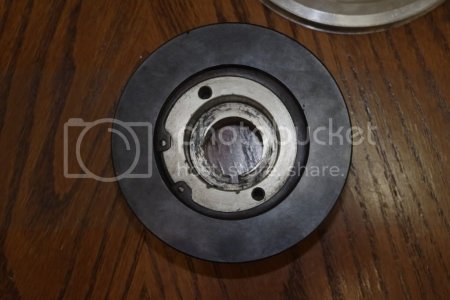

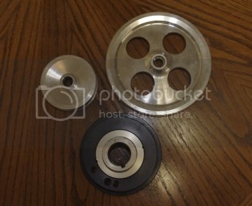

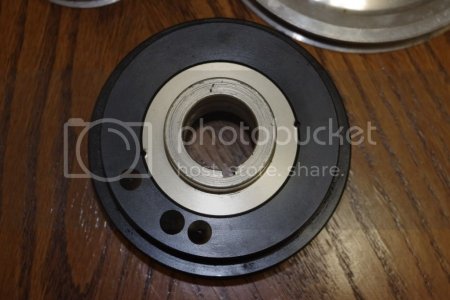

I have an underdrive crank damper and i've also been able to track down the SHOShop underdrive power steering and alternator pulleys. The crank pulley is a smaller diameter and the SHOShop pulleys are larger diameter. I understand the principle of how they work, but what i need to know is can they be used together? If i use the undersize crank pulley with the 2 oversized pulleys will that cause the power steering and alt. to turn too slow?

That's the way the kit was originally sold. I ran mine for a few years and about 80K miles with no issues.

Ok, i didnt know that. I thought the underdrive set consisted of just the water pump, power steering, and alt. So all i need to do now is track down a water pump pulley. Easier said than done though.

What set it your crank pulley from? Is it one of the sho source ones? The only issue I have ever heard about is the alt not charging completely at ilde due to the reduced rotation. Also lights may dim at idle as well. I am running just the sho source crank pulley and havent had any issues. The biggest thing that udp do is save your accessories.

Also don't expect your power steering to be strong at low rpm's with it being underdriven twice.

See, thats what i was worried about. I always thought that a set of UDPs consisted of Alt, PS, and WP only, and that the Crank pulley came about on its own as sort of a substitute to the UDP set. I was thinking that if i used the Crank along with the UDPs that it would cause over-underdriving.

I would not use both sets together! Esp the alt! The old SS set-up were 2 larger acc. pulleys =alt & PS- & the crank pulley was just lightened-but same size-& it had an issue of separating. Even the lightened WP pulley is the same size as stock-just alum-as you don't want to under drive that either.

Ok, so i should go with just the Crank pulley by itself, or just the PS and Alt pulleys by themselves. Makes sense, thats exactly what i was thinking. I should get better results by going with the crank so i guess thats the route i'll take.

Is the crank pulley 1 piece, or two?
The 2 piece (Hypertech) pulley likes to seperate.

Each pulley in the set is larger than stock for this type of setup, which drives the selected accessories slower. The A/C still runs at the stock ratio to the crank.
If I wanted to only underdrive the alternator I could swap in stock P/S and WP pullies. If I were having heating problems but everything else was fine I could just put the stock WP pulley back on.
I'd have to measure for a new belt, of course.
A smaller crank pulley underdrives all of the accessories. It's everything or nothing.
