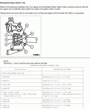

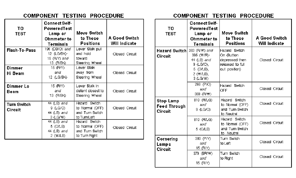

The MFS are know to get dirty and cause turn signal, wiper problems. The Headlight circuit on G1 & 2s pumps full powers through the headlight switch then through the MFS. A know problem.
Get a new MFS and a headlight harness.
SHOZ123
Dec 2, 2000
12,152
673
Illinois
If you are cheap or frugal or economically efficent you can try to clean the MFS. I had good luck by removing mine and throughly dousing it in WD40 whilst working all the functions repeatedly. This will help get rid the dried grease if that is the problem but not for advanced corrosion.
You should also pry off the wiper end cap and carefully remove the small contact "fingers" and clean off the old grease. Regrease with petroleum jelly.
http://www.supermotors.net/getfile/165785/original/windshield-wiper-switch-test-94.gif
Windshield wiper switch test 94
http://www.supermotors.net/getfile/180958/original/mfs-test-procedure.gif
Mfs test procedure
