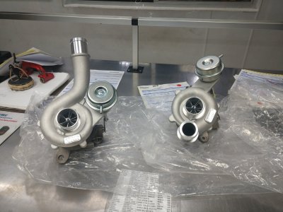

After being on the waiting list I finally got some turbos.. Looking to install in a couple weeks and see what kinda et's it will go.. I maxed out on the stockers hopefully pick up a couple tenths with these.. What do you think 11.84 at 117.28 on stock turbo comparison to upgrade turbo?? I'm hoping 11.50..

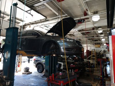

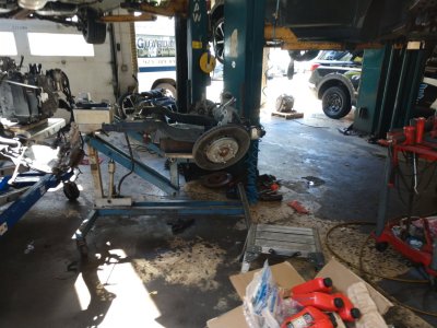

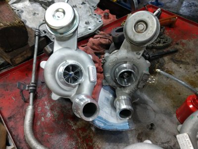

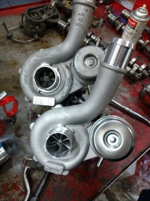

Work began 11:30 this morning.. Working on it between other jobs.. Also doing the ptu preventative maintenance.. I have esp..

Finished it up yesterday afternoon drove around with a stock tune nice and easy to break in.. Loaded up the AO tune Matt sent me this morning to whip on it a little she pulls nice but out of the hole the 1 2 shift it cuts out.. So i sent a data log and see whats up.. I going to get some e85 and load that tune and see if it does it.. Im sure we will get dialed in by the weekend..
