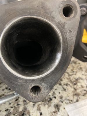

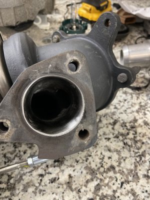

Any of you interested in buying my Gen3R turbos dm me. Ceramic coated and ported. $ave and keep your cores. I never ran them. They have maybe 300 miles? @Jordan_R sold them to me. I’m going to do custom turbos and no longer plan to use them. Edit: Sold! A305674C C18E 4FC0 8542 358FE6ABE871027AA76D 6562 40E1 88F5 94DE808116B0F71EB7F7 731F 4632 9C73 90B2318932BA
