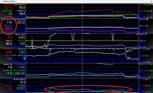

After running Torque Pro on my 2018 PP and seeing what kind of milage I'm getting now I've put 500+ miles on it I have questions..
Is it possible to tune the car to stay out of boost? I noticed on even pretty light pedal inputs it's pretty easy to get into boost, and while cruising around town even though I think my foot is pretty light it's hard to accelerate slow enough to stay way into vacuum. I suppose at least it must be possible to change up the drive by wire curve to soften it up, right?
Is 40+ degrees of timing in low load situations right? or maybe Torque Pro is reading wrong? That seems super duper aggressive.
Is it possible to have tunes which have different parameters based on the shifter position? Would be neat to have drive be a sort of "eco" mode and sport be the high power tune...
This one's a stretch but after some googling I couldn't find any definitive answers... has anyone experimented at all with cylinder deactivation on this engine? I'm guessing it's probably not possible with the stock ECU...
TL;DR Yes sports car go brrr... but what if we're just getting groceries and they're 40 miles away? Can we tune these cars to hypermile?

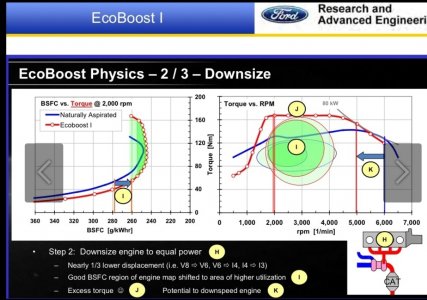

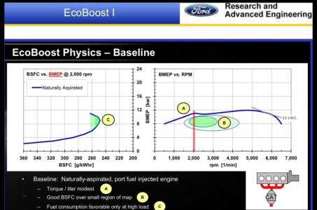

I found these. Screenshot 20220212 001342 ChromeScreenshot 20220212 001104 ChromeScreenshot 20220212 000449 Chrome

Here's a video explaining how it works. It's kind of counterintuitive, but intercoolers can't can't quite cool the air charge down to ambient and this added trick drops it below ambient.
Just wish i had compressor map for the stock turbos. If this could be applied, plus if the available compressor map for t15 turbos is the same, the higher pressure ratio might put it in a higher efficiency island.
