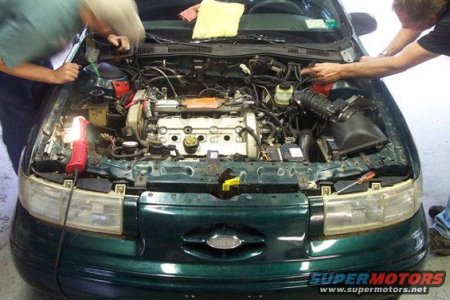

Here is mah boi Brian and my pop getting to know the SHO.

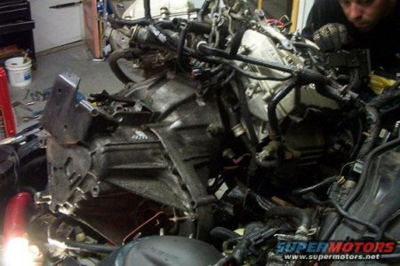

Brian and mike working

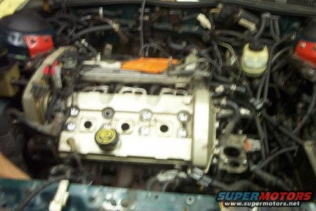

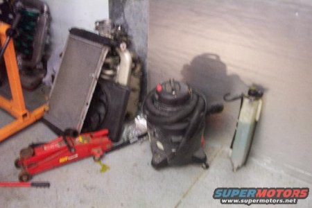

Lotsa stuff in here.
Maze o wires
Parts

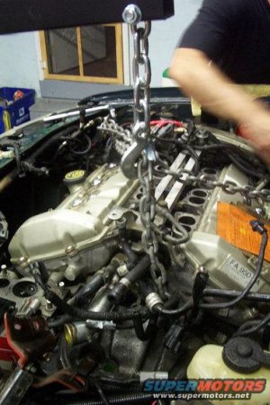

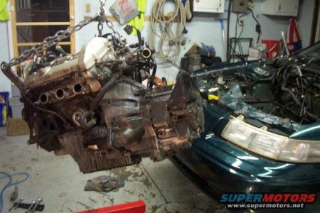

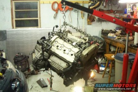

Lifting 1
Putting the chains on.
Lifting 2
Almost there. Mike is looking mighty intent.
Lifting 3

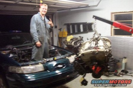

Success.

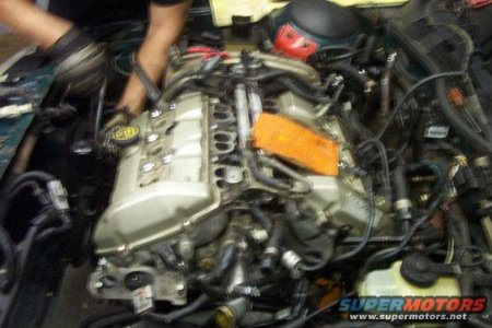

Engine out 1
It decided to hang around for a while. ;)
Engine out 2
Here's Mike looking triumphant, he should. Good job Mike.

So far as the chain goes, if it works, it works.
I'm going to drop that down and begin working on swapping accessories and yanking the tranny.

Hey Tom and Mike, when you go to reinstall, a tip on the chain...
I went around my manifolds, used a rag to protect the valve covers from the chain, and then tied a ratcheting tie down strap around the lift arm of the engine crane and hooked it to the bolts for the black bracket (with the bracket removed, obviously) at the side of the MTX.
Poor man's load leveler FTW. :thumb:

Yeah please take a pic...I'm having a tough time visualizing this. I usually pull from 3 points: the bracket near the alternator, one of the trans bolts, and the bolt behing the power steering pump that holds the bottom part of the bracket for the intake. The problem we had is I forgot the bottom of that bracket is open and I attached the chain to the top part of it. Once we got weight on there from lifting the bracket slid out. I usually go from the bottom but there wasn't sufficient clearance. One of my smarter moves yes...:nut:
