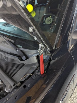

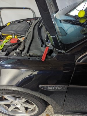

not the bumpers, what are yo doing to keep the hood open do you use a hood prop or do you still use the "shocks"
I use a hood stick or wedge a wrench off the hinge on to the apron/cowl area. I can post a picture when I get home.
