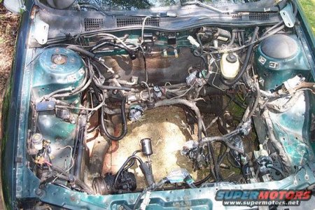

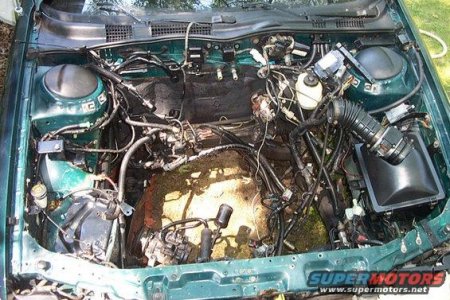

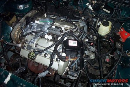

Let's clean the engine bay today.

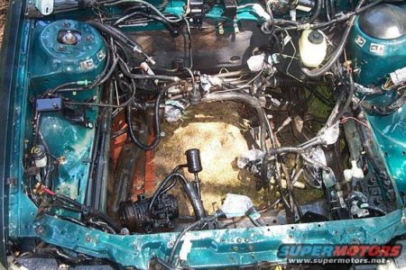

Before. Notice the gunk by the battery tray (left-hand side), mud on the firewall blanket, dull strut towers, ugly subframe goo, and the junk at the top of the fender lips.
Before

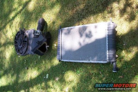

Fan airbox rad dirty
Wrap the electrical connections, please.
Wires wrapped

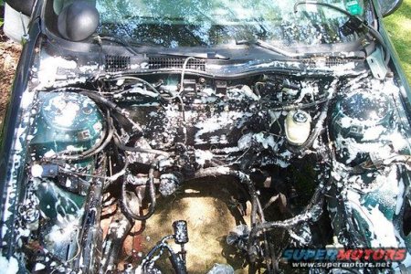

Foamy :)
Foamy
Soaking...
Wet
Now you get in there with the Simple Green and a scrub brush, and two hours later...

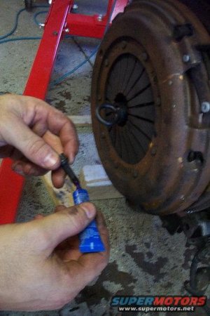

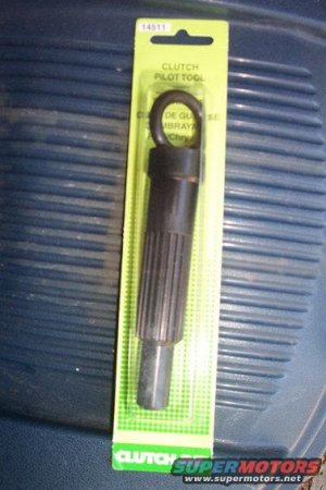

Clutch Alignment Tool. $2.99 at AutoZone. Not needed but helpful.
Clutch alignment tool
Here's it in action... and yes, the bolts are being properly Loctited.
Loctite the pp bolts

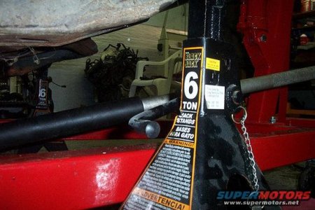

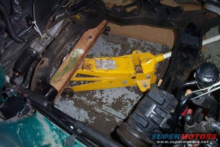

Subframe action.
Subframe action
This jackstand is so overkill :lol:
Subframe action 1
Subframe action 2
Subframe action 3

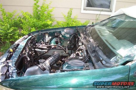

In.
Shes in

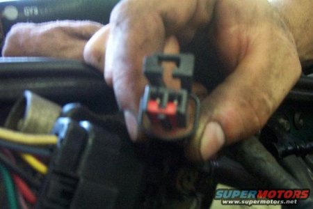

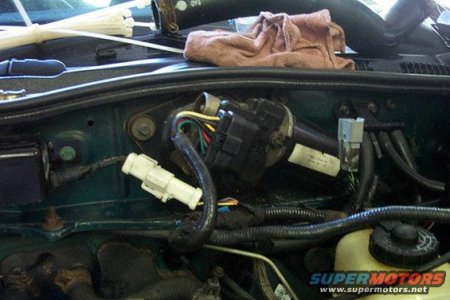

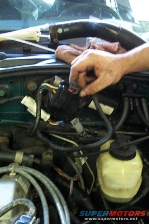

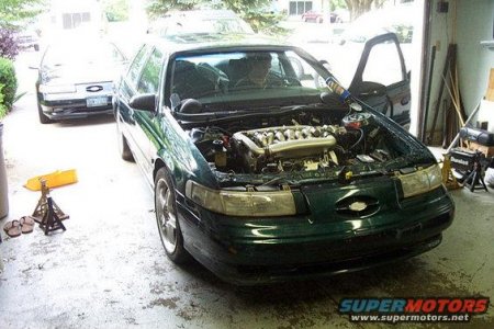

Question: We do not know where this plug goes! Can anyone ID this, please?
What is this plug 4
What is this plug 2
Here's where it comes from on the firewall. Only plug that hasn't found a home yet.
What is this plug 1

Tom, that plugs into the CELO switch.

Small snag last night - one of the exhaust studs busted off inside the manifold. Was a PITA to get it out - but everything is done. Fluids are full, everything is torqued down, battery has juice. CELO plug found its mate. ;) I was saved from having to syphon off old gas through the nastiest tubing ever when we found there was only 1/4 of a tank in there. Oohrah. We're ready to roll.

Well -
Last night, at about 11PM, after two years of sitting and waiting patiently, she came snorting back to life.
There were only a few snags, a pinched starter relay wire and a squished secondary vacuum line, but both were fixed and she starts right up, no drama, no leaks, no squeaks. :biggrin:
