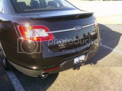

I was able to fit my road bike in the trunk, but since I didn't have any passengers I folded down the seats. I cannot imagine that the bike would fit in the trunk without taking at least the front wheel off otherwise. Since I do plan to haul more than one bicycle and passengers around with the car, I went ahead and installed a trailer hitch receiver (hidden hitch) so I can use my 4-bike Thule. The receiver did not require me to cut anything and is pretty unobtrusive. It also wasn't too bad to install, even by myself.

Do you have a part number for that? I am thinking about a bike rack. Can you use it to tow a waverunner, or is it for light duty only?

The receipt says "90075 Hidden Hitch Class II Trailer Hitch Receiver". I pulled it up via the application guide online for a 2010 SHO. The guide didn't list anything at the time for a 2011 but it fit per the instructions no problem.
As for towing a waverunner, you'll need to check the tow rating of the SHO, tongue weight, etc. to determine if it's rated for something like that. I only use it for bikes. I use my Mountaineer to tow anything substantial.
