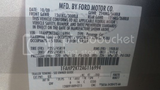

TSB regarding 5th gear start from stop that may apply.
10-21-02 - 6F50/6F55 TRANSMISSION - SLIP/NEUTRAL OUT, 5TH GEAR START FROM STOP, ELECTRONIC PRNDL ERROR, BACKUP CAMERA IN D - BUILT 3/13/2009-6/30/2010
http://www.ecoboostperformanceforum.com/index.php/topic,496.msg23786.html#msg23786
I accually had cel regarding TR sensor occur when I loaded the tune. I thought it to be a normal weird thing that happens when loading but may be related. I cleared code loaded tune and cel has never re-occured. TSB is limited to build date. Where do I find that? Upper left on this sticker?20160326 095858 zpseluv3p8w
