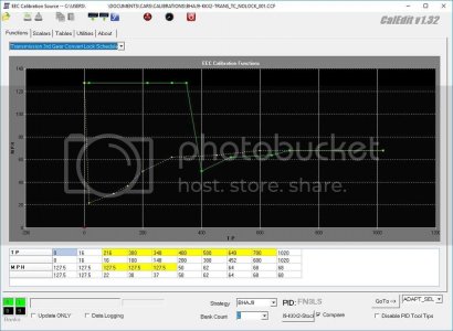

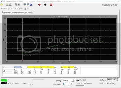

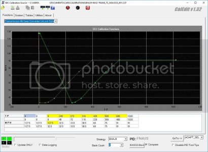

Well I haven't been able to find a scalar or function that would control the hysteresis of the unlock as of yet, but I was able to basically stop the lockups from occurring. Basically what I did was change low speed lockups to a higher speed. This effectively stops the transmission from attempting to lockup. Below show the changes I made. The yellow highlights represent the differences from the stock settings.
3rd Lock

3rd UnLock

4th UnLock
TC NoLock 4thUnlock zpstrmqwaxu
Now lockup in 4th wont start until about 83mph. Just as a note I did change the mph of the 7th column in the 4th lockup to 85mph..
