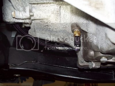

Anyone have a picture where the drain plug is so I don't have to remove my belly pan to go look?

Yes! I do.
In this image below, it is the bolt to the right of (& lower than) where you see the brass fitting, with wiring harness I used for my Trans Temp Gauge.
004 3
This picture is standing at the driver's side, and looking towards the passenger side if you need a point of reference.

Thanks Mike..
