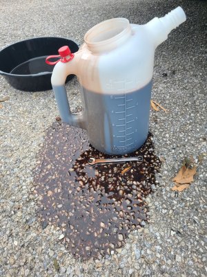

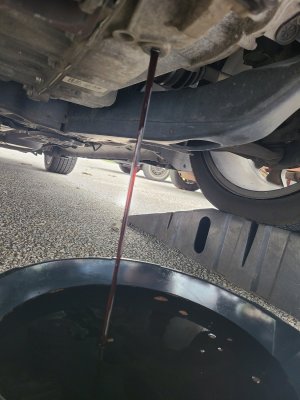

2015 sho non pp transmission. 11mm wrench for the plug. The other one that looks similar is smaller in head size, the 11mm fronter one is the drain plug.
After draining it completely with the engine off, nearly 5.5 quarts came out. Accounting for the bit i spilled. I cleaned out my jug and filled it back up with new fluid to dump back in.

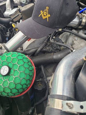

Refilled with Amsoil Mercon LV. Factory you have to remove the air box to get to the fill cap, i had to remove my not factory air filter ducts/shields. And the black cap is where it gets filt, bottom center of last picture ;)
