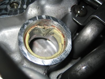

Did the old seal come out of the valve body? It a typical for the seal to be stuck. It is steel lined and usually pried out with a screwdriver. Careful not gouge the aluminum bore of the valve body.
IMG 2144 295835543

That's exactly what mine did,I just wasn't sure if it was supposed to be there or not. The new filter doesn't have a steel liner. Is the liner only on the filter from the factory ? Thanks for the reply,I'll carefully remove the old liner and get the SHO on the road !
